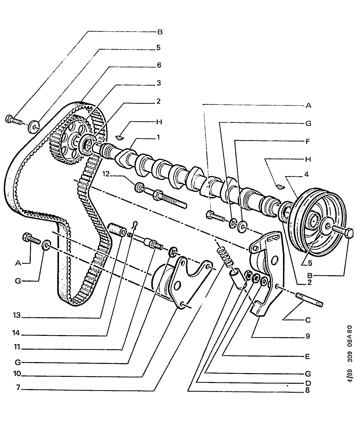

0801 C2 |
ARBRE A CAMES LONG
- SAUF XUD7T
0801 C9 |
- XUD7T
0236 14 |
JOINT D'ARBRE 35X50-8
0805 30 |
PIGNON 42 DTS
0812 08 |
POULIE
0812 09 |
RONDELLE PLATE 10,2X36X5
0816 58 |
COURROIE CRANTE 136 DENTS
DAYCO PIRELLI-
0827 15 |
RESSORT DIAM EXT 24,2LON70,4
0827 16 |
GUIDE RESSORT
0829 11 |
GALET TENDEUR
0830 02 |
GALET FIXE
| 11 |
0830 03 NFP |
AXE
JUSQU'A 09/1987
0830 07 |
DEPUIS 09/1987
| 12 |
0830 09 |
DEPUIS 09/1987
| 13 |
0830 04 NFP |
BAGUE ELASTIQUE
JUSQU'A 09/1987
0830 08 |
DIAM EXT 18-44,5
DEPUIS 09/1987
| 14 |
0830 05 |
EPINGLE
JUSQU'A 09/1987
6993 88 |
SACHET DE VIS 8X125-25
6917 65 |
VIS TH 10X150-35
6930 62 |
GOUJON 8X125-16-20-16-16
6932 38 |
ECROU HEXAGONAL 8X125-6,5
| 9E |
6947 78 |
RONDELLE PLATE 8X16-1,5
| 9F |
6947 79 |
8 X 22 - 2,5
| 9G |
6962 13 |
RONDELLE ELAST 8X17-0,8
| 9H |
6976 09 |
CLAVETTE 15X5-6,5
